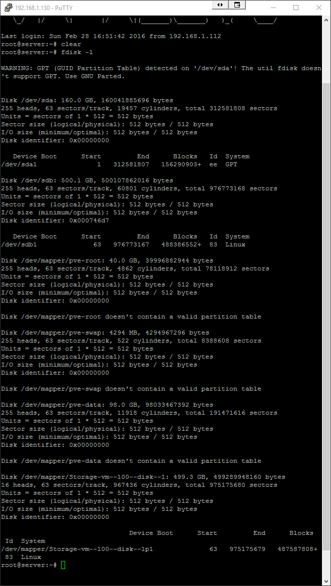

I’m trying to help you but you can’t seem to answer any question,
- I presume that the terminal that you show me is from proxmox…
I see two disk:
sda 160 GB
sdb 500 GB
After that i see various partition that are most likely on those two disk,
Are those partitions are for your Kermit VM? Yes or no
Or it for all vms?
The 160 is my boot device, there is 70gb of that partitioned for the file server and the 500gb is dedicated to the file server.

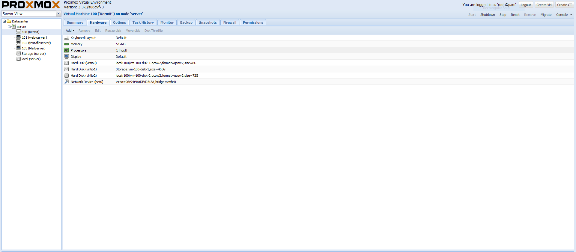

Has this VM ever booted? Can you screenshot the ProxMox panel where the HDDs are listed?
Does any of the other vm work correctly?
cause: … doesn’t contain a valid partition table → is really not good,
with any live cd you could check in 2 min if one of the drive is failling
It has been sitting there for 20hrs or so frozen. All I can access is Proxmox.
Shut down that VM, create a new one with 1 VHDD for the OS, then once the install is done shut it down and add the second drive, from the other HDD.
