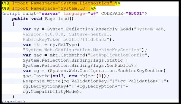

CISA received six files related to Microsoft SharePoint vulnerabilities: CVE-2025-49704 [CWE-94: Code Injection], CVE-2025-49706 [CWE-287: Improper Authentication], CVE-2025-53770 [CWE-502: Deserialization of Trusted Data], and CVE-2025-53771 [CWE-287: Improper Authentication]. According to Microsoft, cyber threat actors have chained CVE-2025-49706 (a network spoofing vulnerability) and CVE-2025-49704 (a remote code execution (RCE) vulnerability) in an exploit chain known as “ToolShell” to gain unauthorized access to on-premise SharePoint servers. Microsoft has not confirmed exploitation of CVE-2025-53771; however, CISA assesses exploitation is likely because it can be chained with CVE-2025-53770 to bypass previously disclosed vulnerabilities CVE-2025-49704 and
CVE-2025-49706.

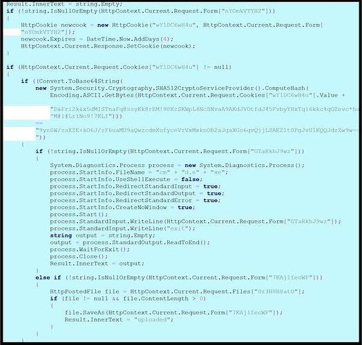

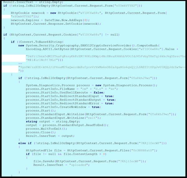

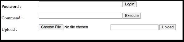

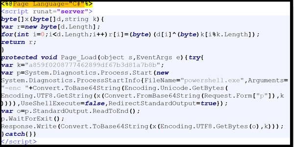

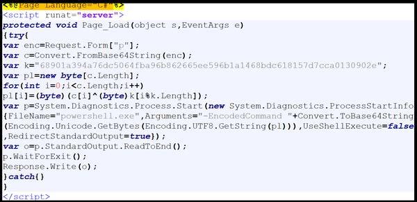

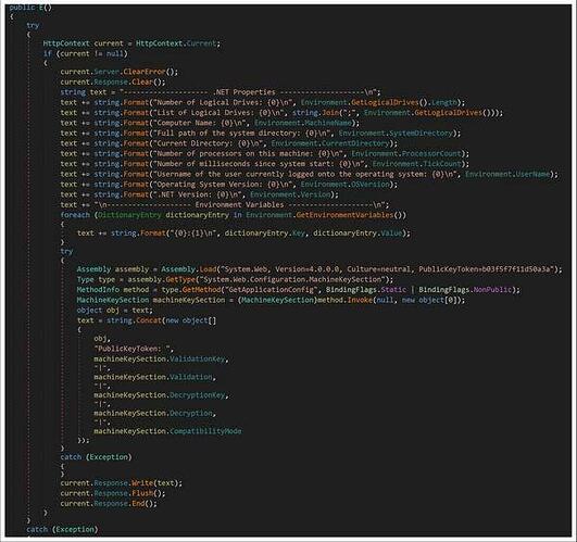

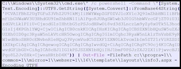

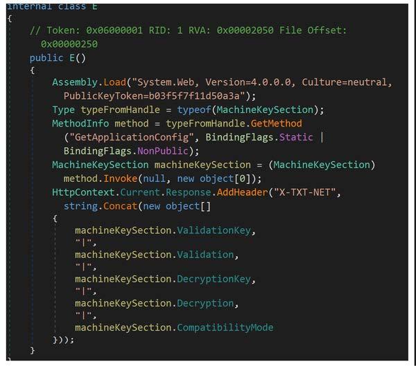

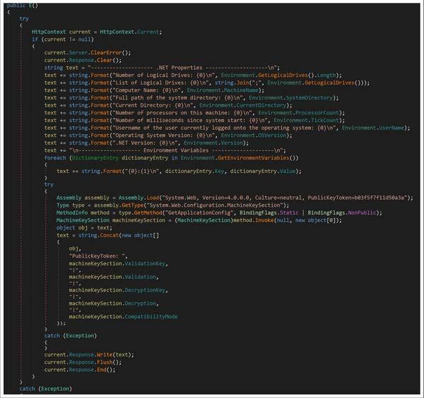

The analysis includes two Base64 encoded .NET Dynamic-link Library (DLL) binaries and four Active Server Page Extended [ASPX] files. The decoded DLLs are designed to retrieve machine key settings within an ASP[.]NET application's configuration and add the retrieved machine key values to the Hypertext Transfer Protocol (HTTP) response header.
The first ASPX file is used to retrieve and output machine key information from an ASP[.]NET application’s configuration. The next ASPX file contains a command-line instruction used to execute a PowerShell command. The PowerShell command is designed to Base64 decode and install a malicious ASPX webshell on disk. The webshell is used to handle various web-related operations, including setting and retrieving HTTP cookies, command execution and uploading files. The remaining two ASPX webshells are used to execute a command using PowerShell on the server.
CISA encourages organizations to use the indicators of compromise (IOCs) and detection signatures in this Malware Analysis Report to identify malware samples. For more information on these CVEs, see CISA Alert Microsoft Releases Guidance on Exploitation of SharePoint Vulnerabilities.

60a37499f9... Contains bee94b93c1796981a55d7bd27a32345a61304a88ed6cd70a5f7a402f1332df72
Description

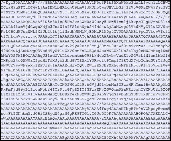

This artifact is a data file containing the Base64 encoded .NET DLL "bjcloiyq.dll" (bee94b93c1...).
Screenshots
Figure 1 - Screenshot of a snippet of the data file.

Relationships
bee94b93c1... Contained_Within 60a37499f9b02c203af24c2dfd7fdb3834cea707c4c56b410a7e68376938c4b7
Description
This artifact is a 64-bit .NET DLL that contains a class named "E" (Figure 2) used to extract and concatenate machine key configuration settings within an ASP[.]NET application's configuration. The file uses reflection to access the "MachineKeySection" from the "System.Web" assembly, which contains cryptographic keys used for validation and decryption in ASP[.]NET. The file uses reflection to get and invoke the "GetApplicationConfig" method of the "MachineKeySection" class to retrieve the "machineKey" configuration, which holds the actual key values. The file constructs a string containing the "ValidationKey", "Validation", "DecryptionKey", "Decryption", and "CompatibilityMode" properties of the "machineKeySection" and adds it as a custom header named "X-TXT-NET" to the HTTP response.
Screenshots
Figure 2 - Screenshot of the decompiled .NET assembly within a class named "E" used to extract the machine key configuration.

Description
This artifact is a 32-bit .NET DLL that contains a class named "E" (Figure 3) used to retrieve system and environment information, along with the machine key configuration settings (Figure 3). This class file is designed to iterate through and collect environment variables as well as retrieve and format .NET and system properties below:
--Begin System Properties--
Number of logical drives
Drive letters
Computer name
Full path of the system directory
Current directory
Processor count
System uptime (milliseconds since start)
Username
Operating system version
.NET version
--End System Properties--
The file uses reflection to access the "MachineKeySection" from the "System.Web" assembly, which contains cryptographic keys used for validation and decryption in ASP[.]NET. The file uses reflection to invoke the "GetApplicationConfig" method of the "MachineKeySection" class to retrieve the "machineKey" configuration, which holds the actual key values. The file constructs a string containing the "ValidationKey", "Validation", "DecryptionKey", "Decryption", and "CompatibilityMode" properties of the "machineKeySection". The gathered information and the "MachineKeySection" details are formatted into a string before written to the HTTP response (current.Response object).
Screenshots
Figure 3 - Screenshot of the decompiled .NET assembly that contains a class named "E" used to retrieve and display system and environment information, along with the machine key configuration settings.

ssdeep Matches
No matches found.
Description
This artifact is a malicious ASPX file used to retrieve and output machine key information from the "MachineKeySection" of the System[.]Web[.]Configuration namespace (Figure 4). This file uses reflection to dynamically load the "System.Web" assembly and access the "MachineKeySection" class within "System.Web.Configuration". The file invokes "GetApplicationConfig" to retrieve the "MachineKeySection" object and writes its properties including, ValidationKey, Validation, DecryptionKey, Decryption, and CompatibilityMode to the HTTP response using the "Response.Write()" method.
Screenshots
Figure 4 - Screenshot of the contents of the ASPX file used to extract configuration information from the machine key section of a web application's Web.config file.

Relationships
9340bf7378... Contains 675a10e87c248d0f629da864ba8b7fd92b62323c406a69dec35a0e6e1552ecbc
Description
This artifact contains command-line instruction used to execute a PowerShell command (Figure 5). The PowerShell command decodes a Base64 encoded string into a Unicode Transformation Format-8 (UTF-8) string. The decoded content is then written to a file named "info3.aspx" (675a10e87c24....) located at c:\progra~1\\common~1\micros~1\webser~1\l16\template\layouts\. The output file is encoded using UTF8.
Screenshots
Figure 5 - Screenshot of the contents of the file containing command-line instruction used to execute a PowerShell command.

This artifact is a malicious ASP[.]NET web page (.aspx) that contains ASP[.]NET code embedded within an HTML structure. This file is a webshell installed by "info3.aspx" (9340bf73782....). The file handles various operations based on submitted form data or HTTP cookies. The file contains HTML code used to create forms. The forms allow the Threat Actor (TA) to enter a password and submit it using a "Login" button, enter a command into a text field, which can then be executed by clicking an "Execute" button, and upload files that includes two input fields: one for selecting a file (type="file") and another for text input (type="text") (Figure 7).
The password form element is configured for POST method and the input field is named "nYOmkVTYH2". If the HTML form with a password is received from the TA via an HTTP POST request, the file checks if the submission form field parameter named "nYOmkVTYH2" is not null or empty. If the parameter is present and not empty, the file sets an HTTP Cookie named "wY1DC6wH4u" with a value from the form field "nYOmkVTYH2" and sets the HTTP Cookie expiration date to four days from the current time. This cookie is then added to the response. The file verifies if the HTTP cookie exists in the current HTTP request. If the cookie exists, its value is concatenated with a long hard-coded string "D&Fri2k&x5dMISTnaFq@ssyKk@rEM!98KzSKWpL4Nc8NvaA9AKdJVOtfdJ45FvbyYHxTql6kkc%qOZevc*hu^M#l#LrlNo9!7KLf". This combined string is then hashed using SHA512. The computed hash is converted to a Base64 string and compared against a predefined Base64 encoded string "9gYs0W/reXzR+KO6J/zP6naMU9AQwZCwhmXuPyGeY2VwMkxNGBZaJQAxGS6GvQZJLSAPk8LT0PgJVU1kQQJd2zW9w==" (Figure 6). This process determines whether a user or request is authorized.
The command form element is configured for POST method and the input field is named "GTaRkhJ9wz". If the HTML form with a command is received from the TA via an HTTP POST request, the file checks if the submission form field parameter named "GTaRkhJ9wz" is not null or empty. If the parameter is present and not empty, the file creates a new process to execute a command-line utility "cmd.exe". The file redirects standard input, output, and error streams to capture the results of the executed command. The code writes the value of the "GTaRkhJ9wz" form parameter to the process's standard input, executing the value as a command, and then writes "exit" to terminate the process (Figure 6).
The file upload form element is configured for POST method and "enctype"="multipart/form-data" to handle file uploads. It includes an input type="file" for selecting a file (input field named "0z3H8H8ato") and an input type="text" for providing a destination path or filename ( input field named "7KAjlfecWF"). If the HTML form for file upload is received from the TA, the file checks if the submission form field parameter named "7KAjlfecWF" (intended to be the file path or name) is not null or empty. The file retrieves the uploaded file through the "0z3H8H8atO" input using "HttpContext.Current[.]Request[.]Files["Oz3H8H8ato"]". If the file exists and has content (content length is greater than zero), the file saves the uploaded file using the path provided in the "7KAjlfecWF" field. Upon successful upload, the "InnerText" of an element named "Result" is set to "uploaded", indicating the file has been saved. If an error occurs during the process, the file captures the exception and displays its details in "Result.InnerText" (Figure 6). The file displays server-side generated output or messages to the TA.
Screenshots
Figure 6 - Screenshot of the code snippet designed for handling various web-related operations, including setting and retrieving HTTP cookies, calculating a SHA512 hash of a request form value, starting an external cmd process and capturing its output, handling uploaded files from a request.
Figure 7 - Screenshot of the form that allows the TA to enter a password and submit it using a "Login" button, to enter a command, which can then be executed by clicking an "Execute" button, and a field for uploading files, featuring a file input (type="file") and a text input, both submitted using an "Upload" button.

Description
This artifact is a malicious ASPX file with a "Page_Load" event handler that constructs and executes a command using PowerShell on the server (Figure 8). Upon execution, the file takes a Base64-encoded string from a form parameter named "p". The Base64 encoded string is decoded and Exclusively-OR (XOR) decrypted using a hard-coded XOR key "68901a394a76dc5064fba96b862665ee596b1a1468bdc618157d7cca0130902e". The output of the XOR decrypted bytes are converted to a Unicode Transformation Format-8 (UTF-8) string and then Base64 encoded. The Base64 encoded string is passed as an argument to the PowerShell process "powershell.exe" using the "-EncodedCommand flag". The file redirects the standard output of the PowerShell process and reads it into a variable "o", which is then written back to the HTTP response.
Screenshots
Figure 8 - Screenshot of the contents of the ASPX file.

Description
This artifact is a malicious ASPX file with a "Page_Load" event handler that constructs and executes a command using PowerShell on the server (Figure 9). Upon execution, the file constructs a PowerShell command that decodes a Base64 string from the request form parameter "p". The decoded string is decrypted using the XOR function with the hard-coded key "a859f0208777462899df67b3d81a7b8b". The decrypted bytes (command) is executed using a PowerShell command. The standard output of the executed PowerShell command is converted to a UTF-8 string, then encrypted using the XOR function with the same hard-coded key. The encrypted bytes data is Base64 encoded before written to the HTTP response using "Response.Write".
Screenshots
Figure 9 - Screenshot of the contents of the ASPX file.
