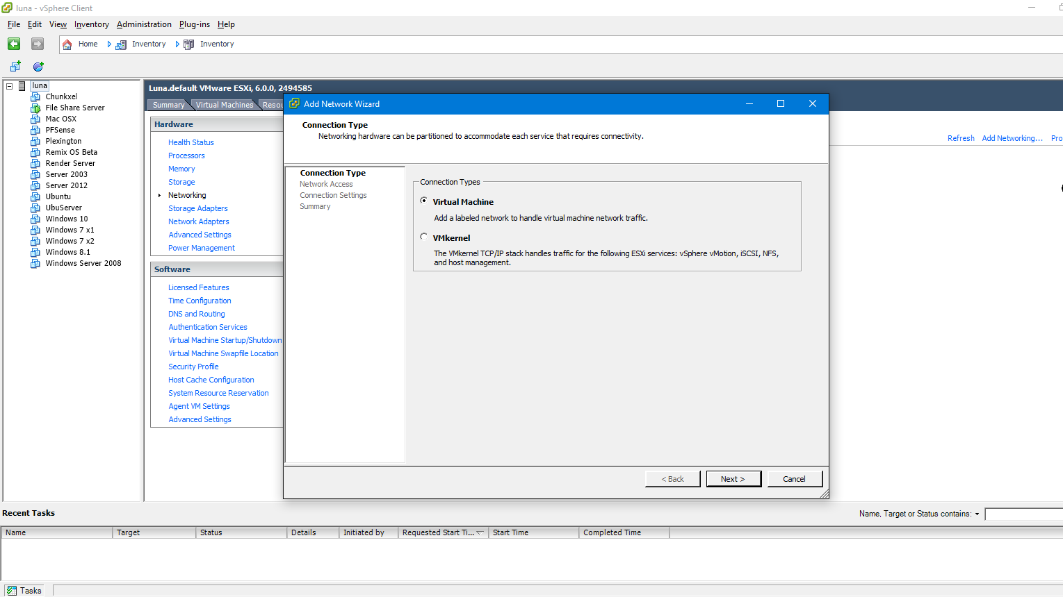

I get this problem with Windows based guest OS’s… Have you made a new network adapter for the NIC in your hosts settings? This is usually under the HOST → Configuration → Networking → Add Networking
