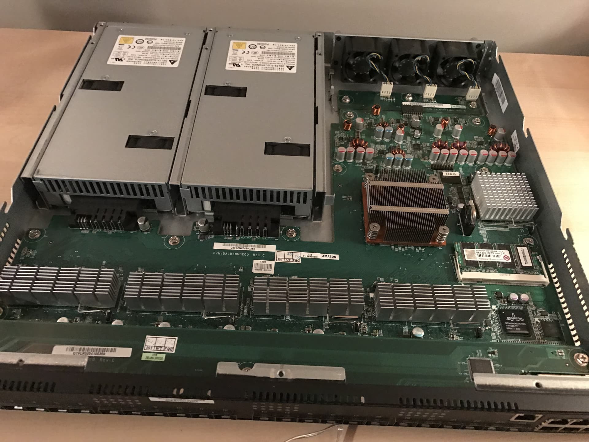

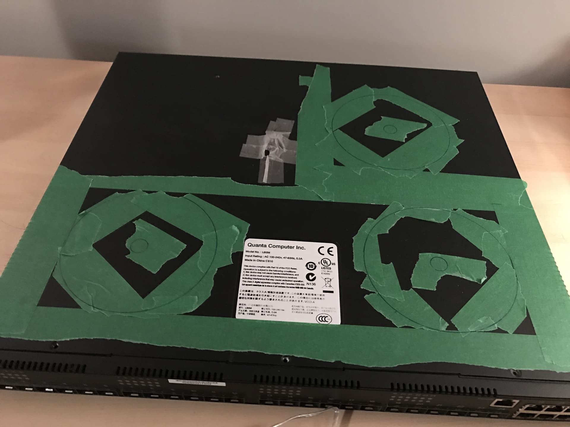

The switch just arrive :slight_smile:, I would like to know your thought about my project. I would like to make the switch quieter because right now the 3 fans in the back are 55dba fan and i cannot have this at home. I’ll be running only one PSU at a time. I will replace the two PSU fan for Noctua 40mm. I would put two Noctua SF-F12 120m fan intake in the front and another one in the back has outake. I would remove the 3 in the back and cover the hole/grill. Tks

I would suggest switching out the fans, and putting some load on it while watching the temp, if it seems normal I’d say you were good but if not then you would probably need to figure something else out.

Someone from Servethehome forum post that he replace all the fan for Noctua 40mm but those fans move less then the half of what the original fan move. The guy was telling that the switch was really hot and smelling burn but it was stil running. I’ve ask a guy on the forum to post a photo of his project with external fans. He have nice cold temperature . Temp (Celsius)… 38 I’ll mesure mine before doing the surgery 😛
04ef2e1a2bebeaea2e7de401c7fe16331c425f6a|666x500

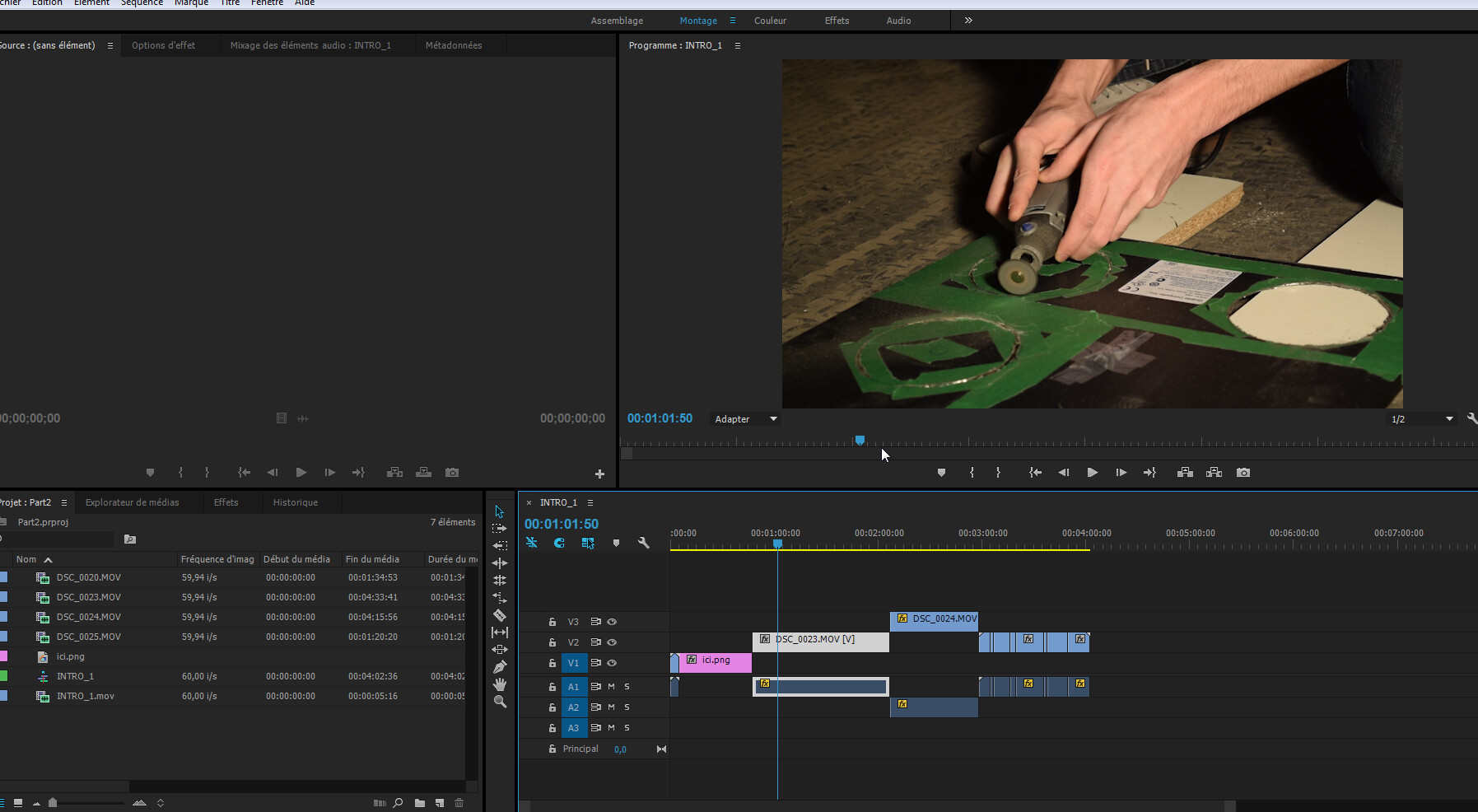

I'm pretty sure when you do your video you don't write your text/speech in advance? I'm having difficulty to tell every thing that i want the rigth way...
When i read a text it seems pretty boring ...

My 10 home silent network project @Liam . The projec is finish i only need to do the video about it … boring stuff

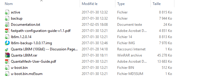

I’ve haven’t play a lot with it since last years. Because it’s been really stable. I didn’t need those feature, layer3 so I didn’t check for it. I was able to get close to the 10GB on Linux and windows 10. But not windows 7. Check this thread Quanta LB6M (10GbE) -- Discussion | ServeTheHome Forums. Really helpful for me for a lot of information. Some of the people were posting bunch of doc in compress file,
319decf5f37824e1d13520780d50745193abc87b
